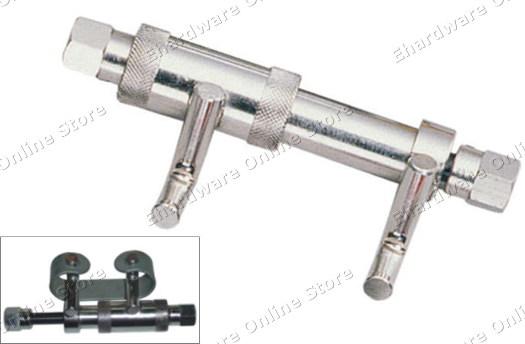

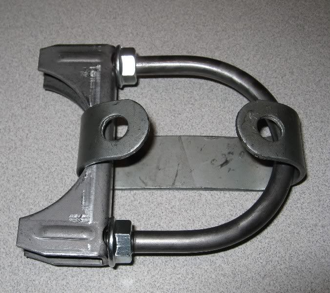

Summuti klambrist abivahend-
http://i288.photobucket.com/albums/ll19 ... p_Tool.jpg" onclick="window.open(this.href);return false;
Spetstööriist
http://76.my/Malaysia/vw-audi-exhaust-s ... 77@114.jpg" onclick="window.open(this.href);return false;
Nutikate leiutis
http://www.partsplaceinc.com/uploads/im ... /3515f.jpg" onclick="window.open(this.href);return false;
